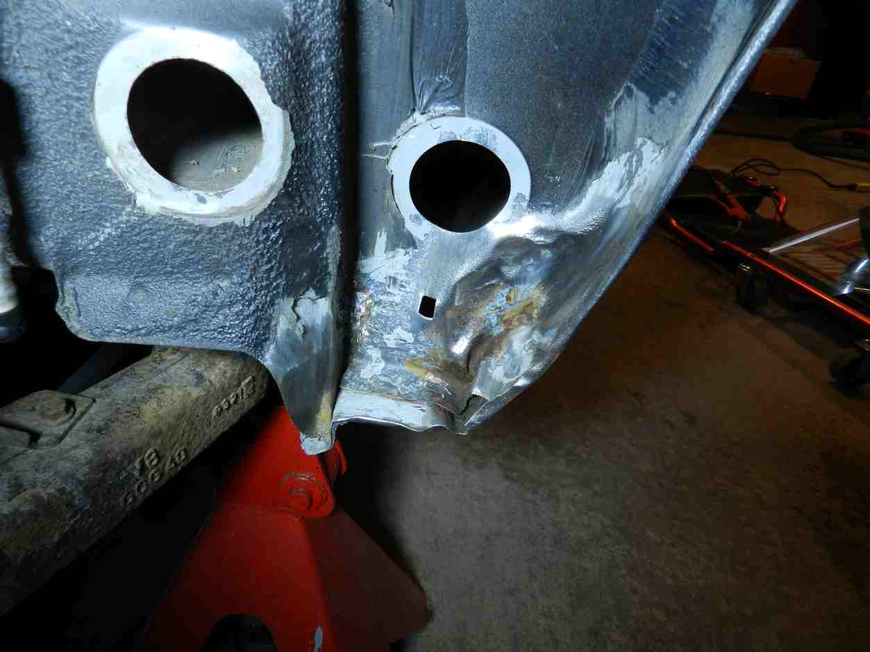

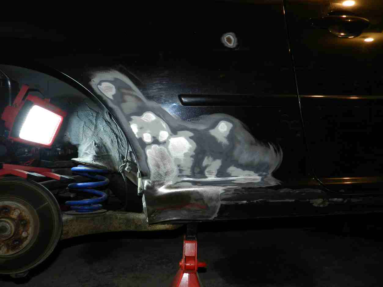

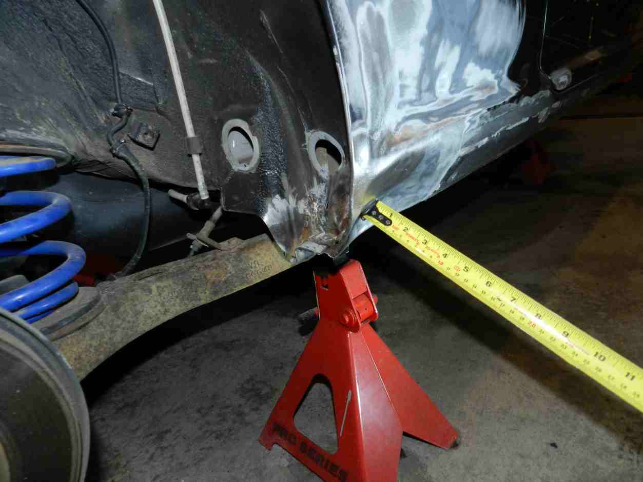

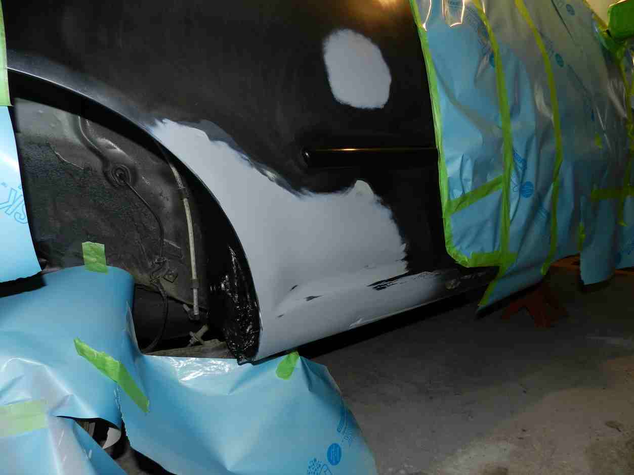

                  Here you go Colin.
                  It is not perfect but way better than it was and the main point, no rust anymore.
                  From over 1" deep crease, I am back to about 1\4" deep. I still need to clean a little inside the rocker panel as stud welding certainly damaged and burned the "inside" paint and fill it with liquid wax.
