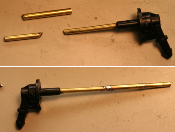

rear washer nozzle repair
  • rear washer nozzle repair
    just saw a post in the retailer forum
    depending on the location of the break, the tube can be repaired.
    pretty self explanatory when you take the rear motor apart.

              That looks like a pic I took ages ago. It is really pretty easy to do but getting the right lenght is the hardest part although I am sure it is not really critical.
                Re: rear washer nozzle repair
                mine broke several years ago. it's a really bad design on VW's part.
                At time time not many people's rear washer had broken so I was able to snag an entire barely used rear wiper motor assembly from some guy in Arizona who shaved his hatch. got it for under $50 shipped to my door
                A friend of mine managed to replace the tube with some kind of plastic tubing that he found at a hobby shop. it fit perfectly, too.
