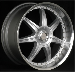

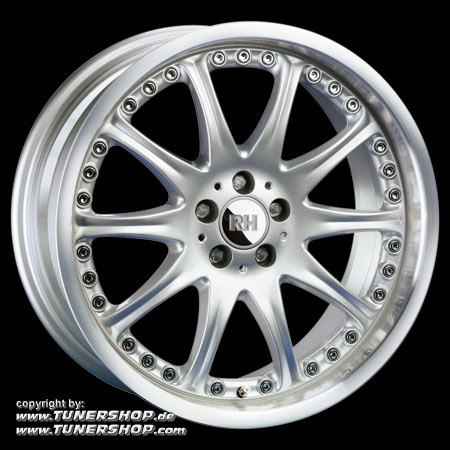

                      I'm not really looking for a mesh wheel, I'm looking more for a six or seven spoke with lip - how can you say these two wheels are that different? Maybe you were thinking about the original axis se7en, the mod se7en is different...here's what I like...damnit - images won't post...

                            One is a 10 spoke with a satin finish and soft edges, the other is a 7 spoke with hard edges. I definitely see a big difference but maybe it is all in my head. The Se7en imo is going to stand out way more, and will look very aggressive compared to the somewhat reserved Phoenix.

                              ok, this is the RH:
                              This is the Axis:
                              That was way more stress then it should have been. I suck at this. anyways, going on a Black 4 door golf, lowered with H&R coilovers, so I can adjust height to fit wheel.
