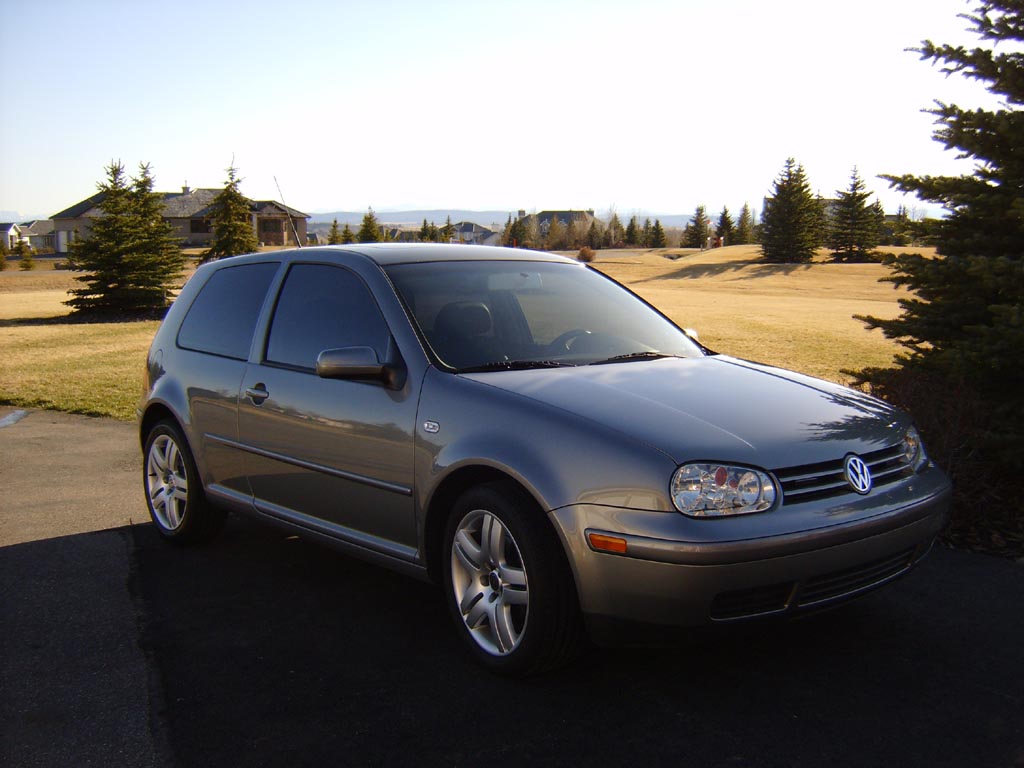

        Ryan, I just sent you email; mine will be for sale shortly.
        thanks
        Tom

          Tom, those look sweet! I emailed you back before I saw the picture. Email me back when you have the chance.
