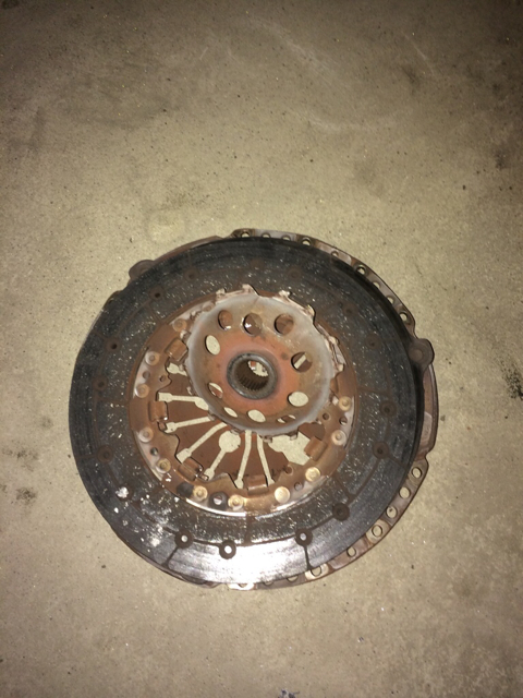

              • #37
                Re: Clutch help
                Update
                I pulled the tranny!!
                Sorry for the bad iPhone pics.
                But I take it this is my problem!
                Silver Stoned
                16' Lithium Gray F150( Winter mode)
                03' 24V VR6
                • #38
                  Re: Clutch help
                  Wow, don't know if I have seen that happen before. How much power are you running?

                  • #39
                    Re: Clutch help
                    Originally posted by 24vr86 View Post
                    Update
                    [ATTACH]4788[/ATTACH]
                    Someone has been doing lots of hard launches

                    • #40
                      Re: Clutch help
                      This car def is not stock power but I have no idea what it has. I know it has a big 2.5/3" turbo back exhaust. Possible tune. But I've yet to hear back from the previous owner.
