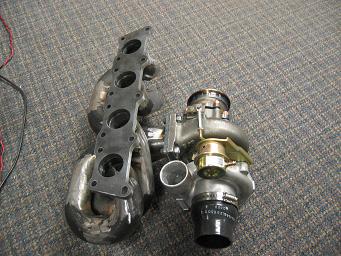

    turbo arrived today. Finished making (looks like crap i know) the prototype equal lenght exhaust manifold. Tried putting it together to see the fit of things... NICE.
    Next week I'm dedicating all time to do this thing right. If all fits well inside the car I'm going to make another super clean and polished exhaust manifold. Installed turbo. Two intercoolers (hidden style). All should be ready by the next NVD meet.

                    Update: Manifold didn't quite fit well with the turbo on the car so I'm altering it a little. Shortening it and getting the turbo closer to the block.
