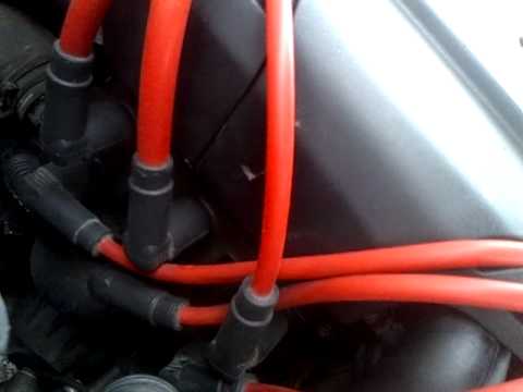

    Hi Guys,
    So I went of vacation for 5 days and came back and my car was running like balls. Drove 15 feet and turned right around and stopped driving. I popped the hood open and noticed that their was a short on my ignition coil and though it was pooched. I took it apart tonight and it looks completely perfect. Cleaned it up a little and everything looks solid. Wondering on what i should do next. What's the best way to test the spark plug wires to see if it's just that one cylinders wire? Would i be better off just buying a new set of wires instead too? Thanks for all the help guys

    I am pretty sure that is your wire. Put a screw driver in front of it and see if it arcs to it
