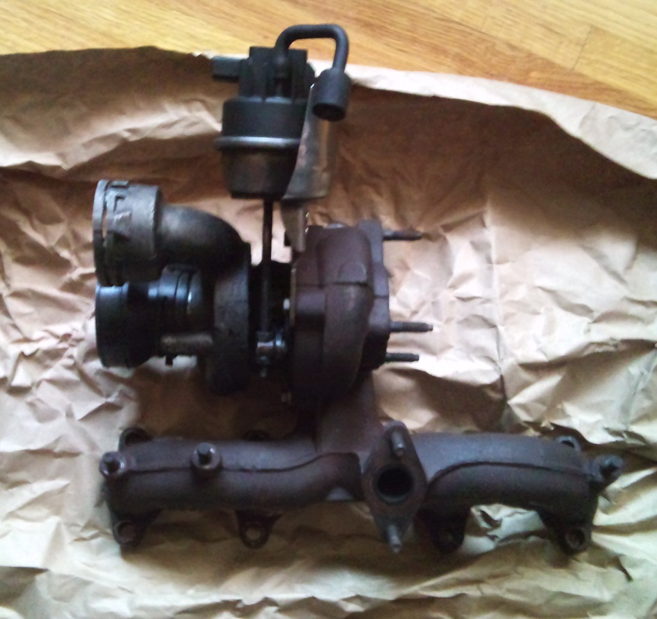

                      Re: Dieselgeek Timing belt kit
                      Just got the "new" turbo. I looks really good, no shaft play and the manifold is really clean inside too.
