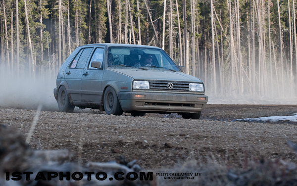

      Here we are in the Trail of the Gnu TSD rally this year. Fun!
