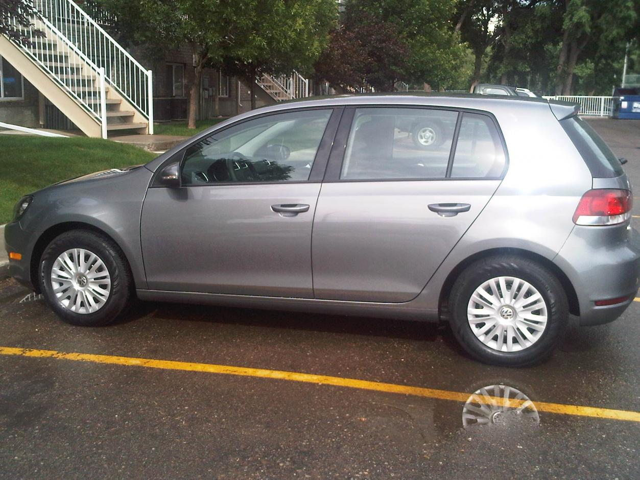

                      No it's not Orange (yet) like my avatar. It's Grey

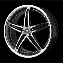

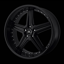

                        If it is the 5 spoke look you dig, these in matt black look very nice... They are also available in black/machined. Very clean, simple wheel. 19x8.5 5-112 ET45 which is a perfect MKVI fitment. Can do a great deal on either of these!

                          hey those aren't bad at all i really like them to be honest. can you pm me about them please!
