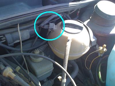

So I did a little searching and I figured out that you were talking about the 'full throttle microswitch'... where is this located on the car?2001.5 Audi S4

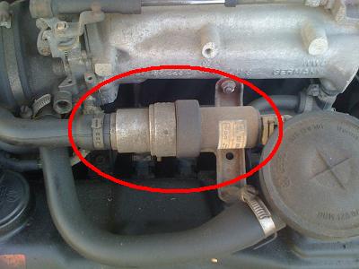

that is your ISV yes.
I thought that sensor in the coolant bottle just measured level and gave the flashing warning when it was low. I could be wrong though.
Can't remember how to diagnose ISV's I thought you could unplug it, it would cause it to idle like crap but wouldn't cause the idle spike. I've had to mess around with a couple of them.

Could just be a dirty ISV. Take it out and clean it, see what happens.
That or it could also be cracked.
