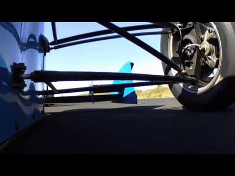

                              Videos
                              Qualy
                              Race 1
                              Race 2
