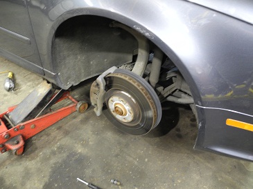

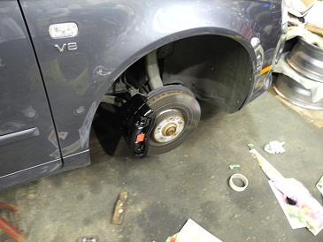

                Finally got to painting my calipers and this is how they turned out.
                Thank you for everyone's input!
