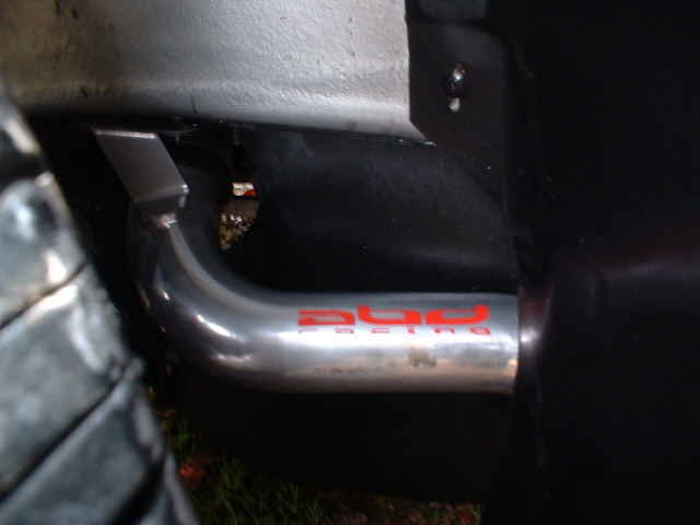

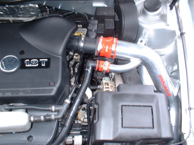

    here are some pics of the rice killer
    ABD LAN pipe
    ABD lower ic pipe
