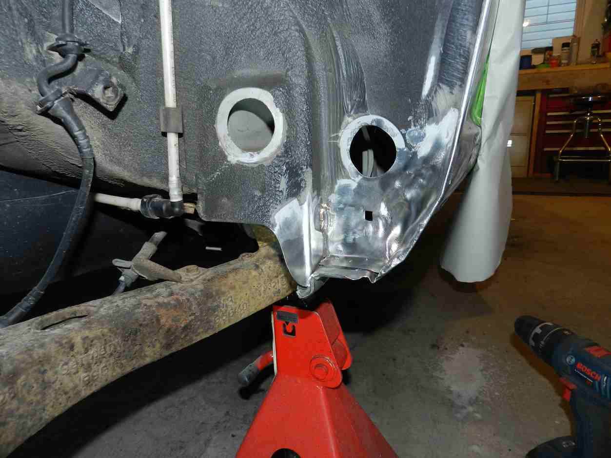

        Re: New to me R32

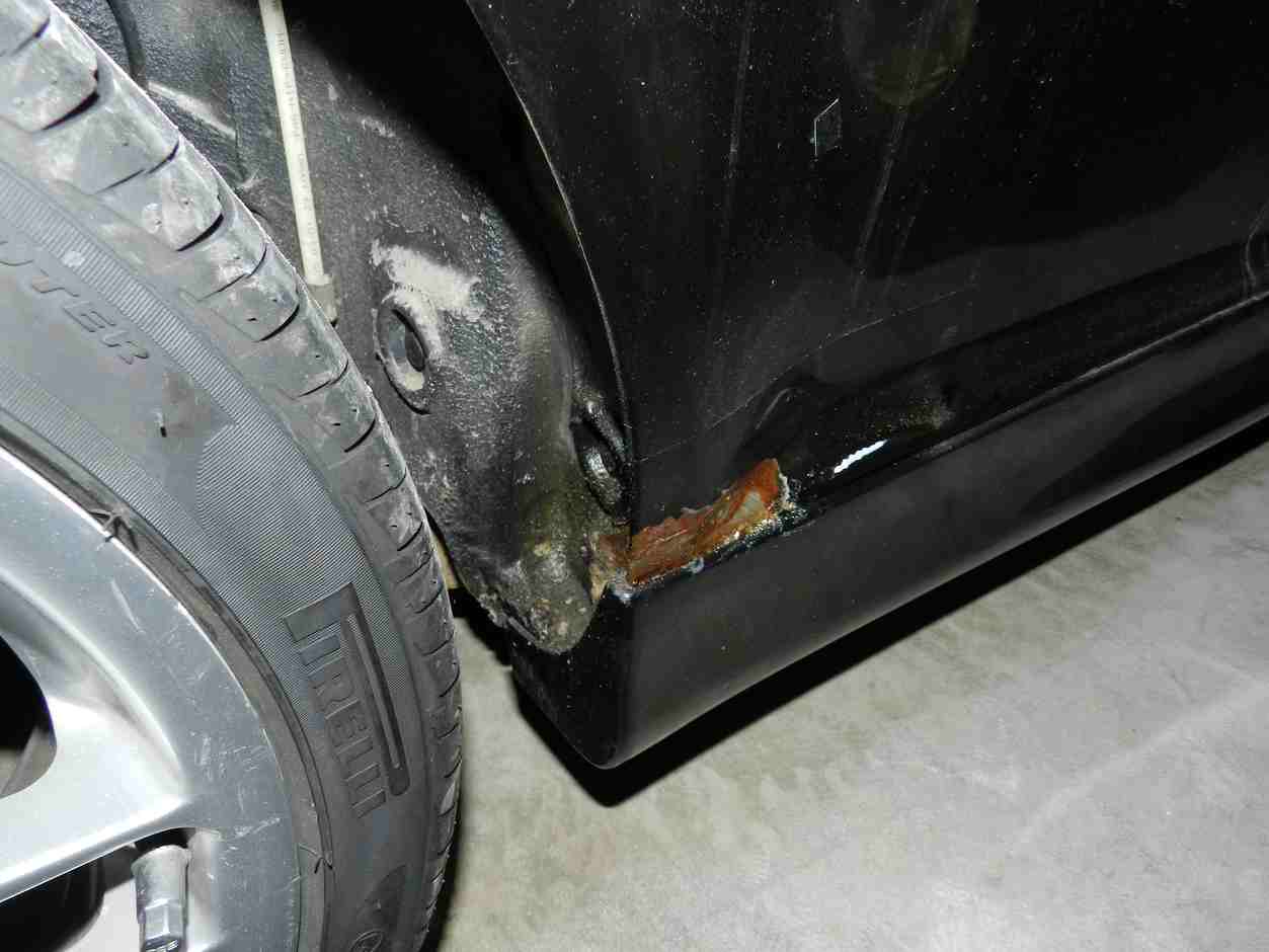

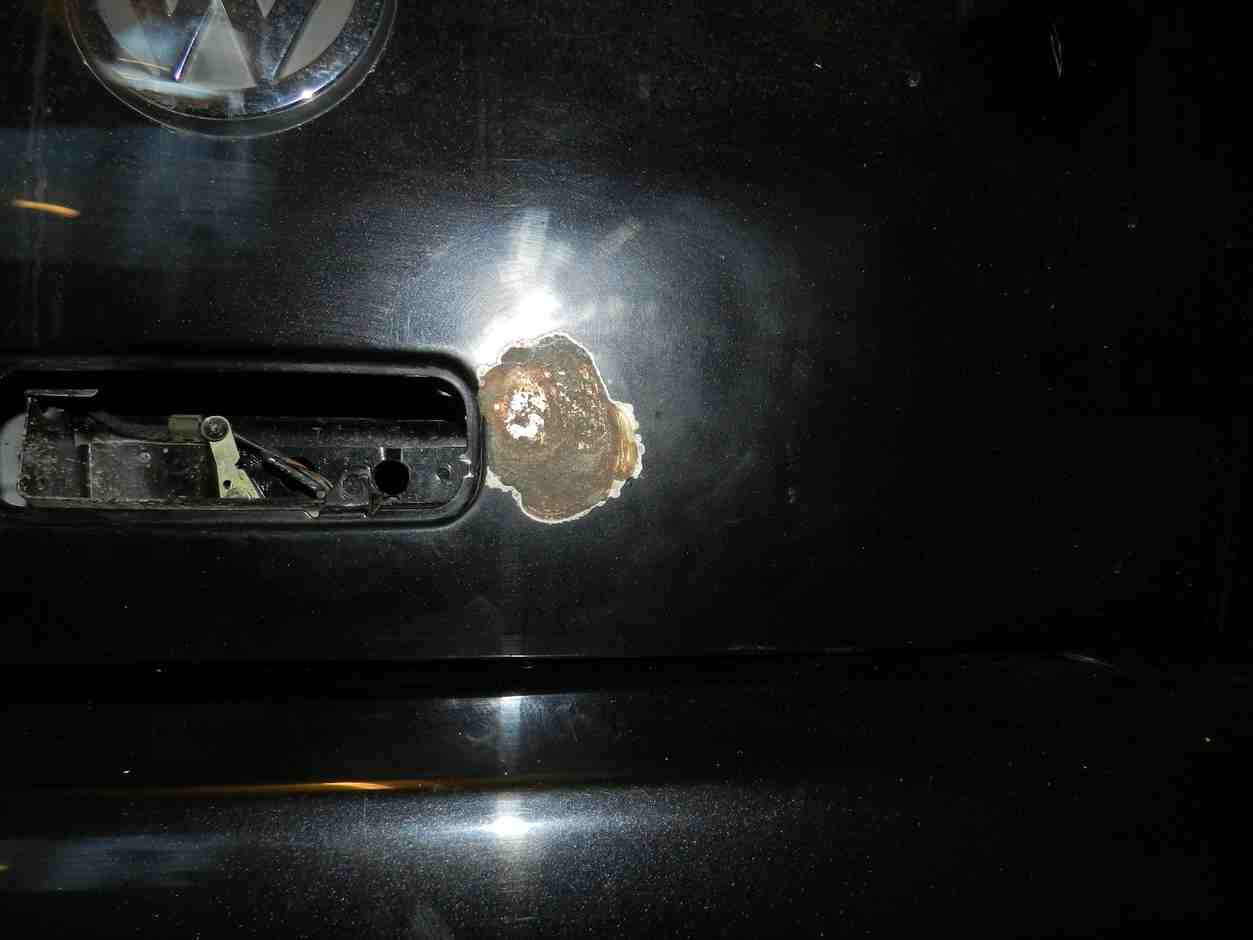

        Almost nothing done on the car except taking apart the hatch's latch to take a look at the rust. Better than I thought, at least it is not from inside.

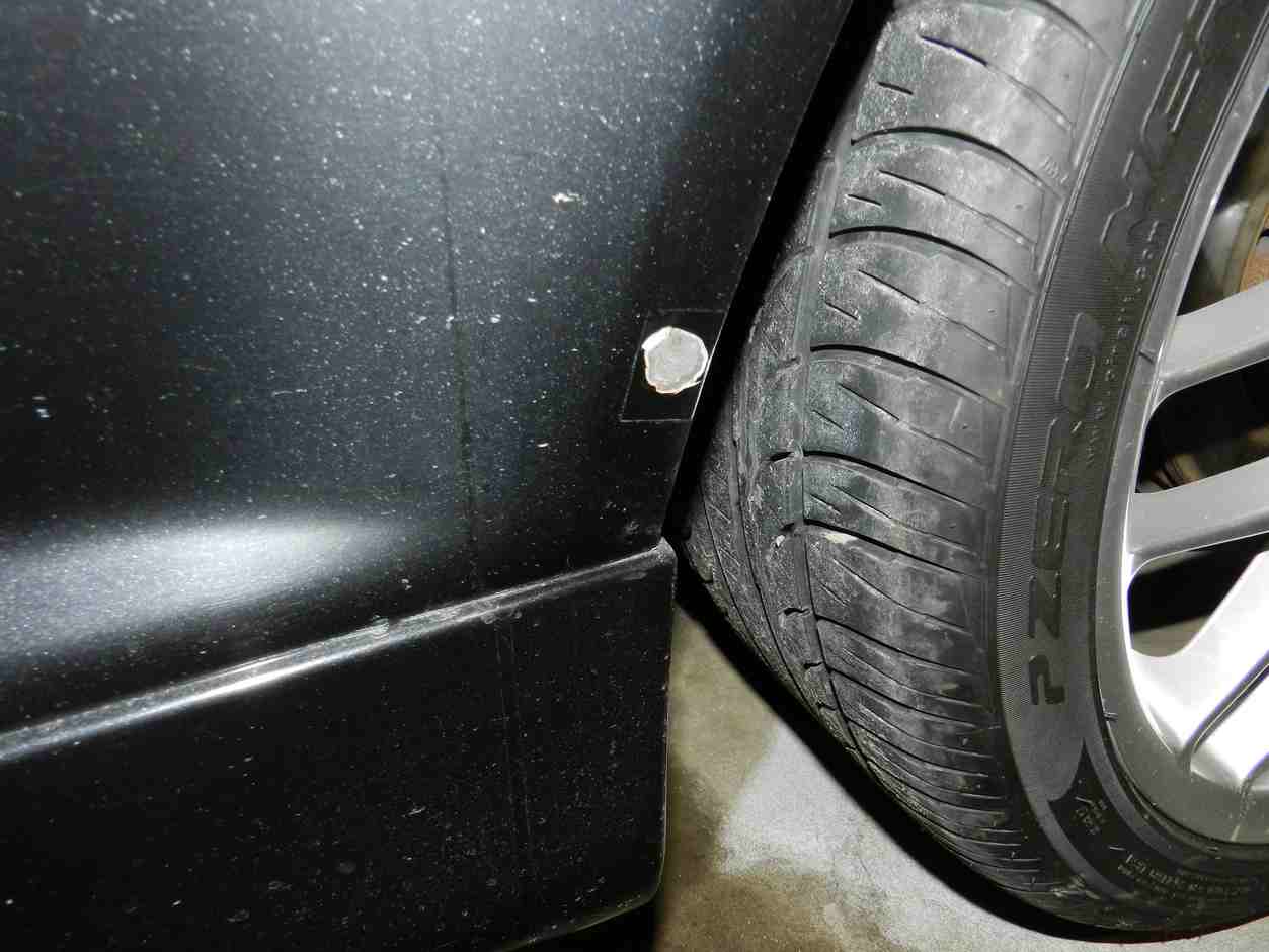

        Little rust bubble on the driver rear quarter panel.
        The worst is here so I guess I will need to cut some metal as there is an impact behind the side skirt and the wheel well is damaged and rusted but it is not visible in the picture.
        Of course, the bottom of both front fenders is rusted too but it shouldn't be too bad.
        I am surprised by all that rust as the under carriage is really clean as well brake and suspension system.....
        I didn't go out for a quote but I guess it will cost at least $5000 to fix and I am not planning to spend that amount of money since the paint isn't perfect to start with on a car with 220,000kms. Anyway, no need for another garage queen as we already have a Miata we barely drive. This car has been driven since day 1 and I am planning to do the same.
        I'll do the job myself, taking my time so hopefully the result will be better than our van. Not planning to use air gun this time as I cannot do everything at the same time but I'll do "1 piece" at the time. For that I think I'll start a thread in the Body & Paint section as I have question about it.
        I forgot to add that all spots but the hatch will certainly be covered in black vinyl in the future since they are exposed to road debris anyway.

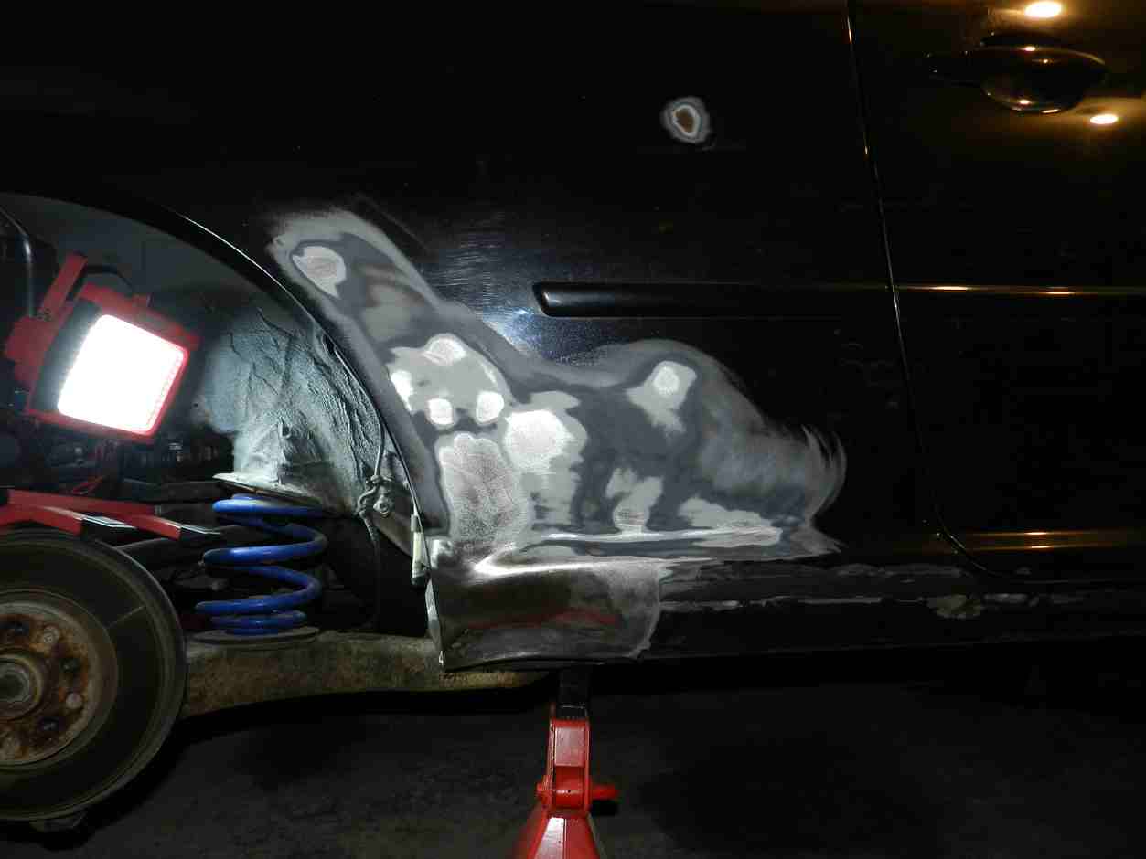

        • #19
          Re: New to me R32

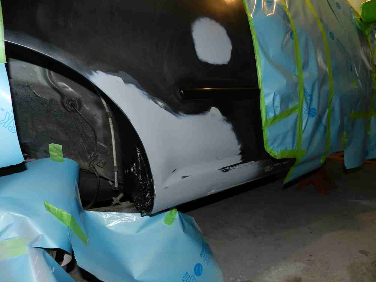

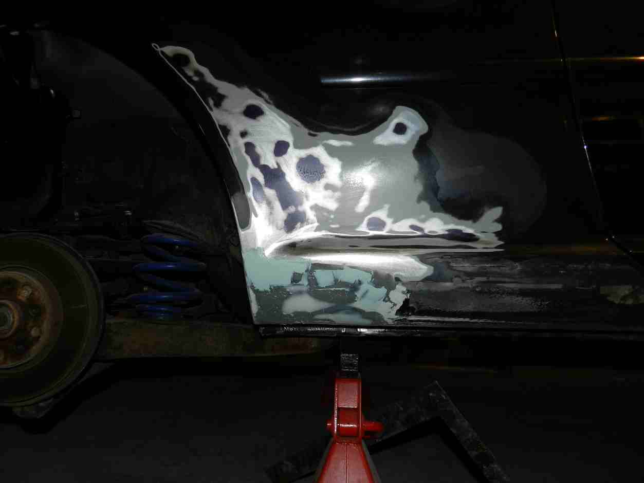

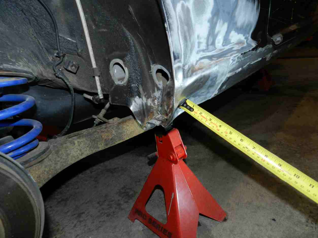

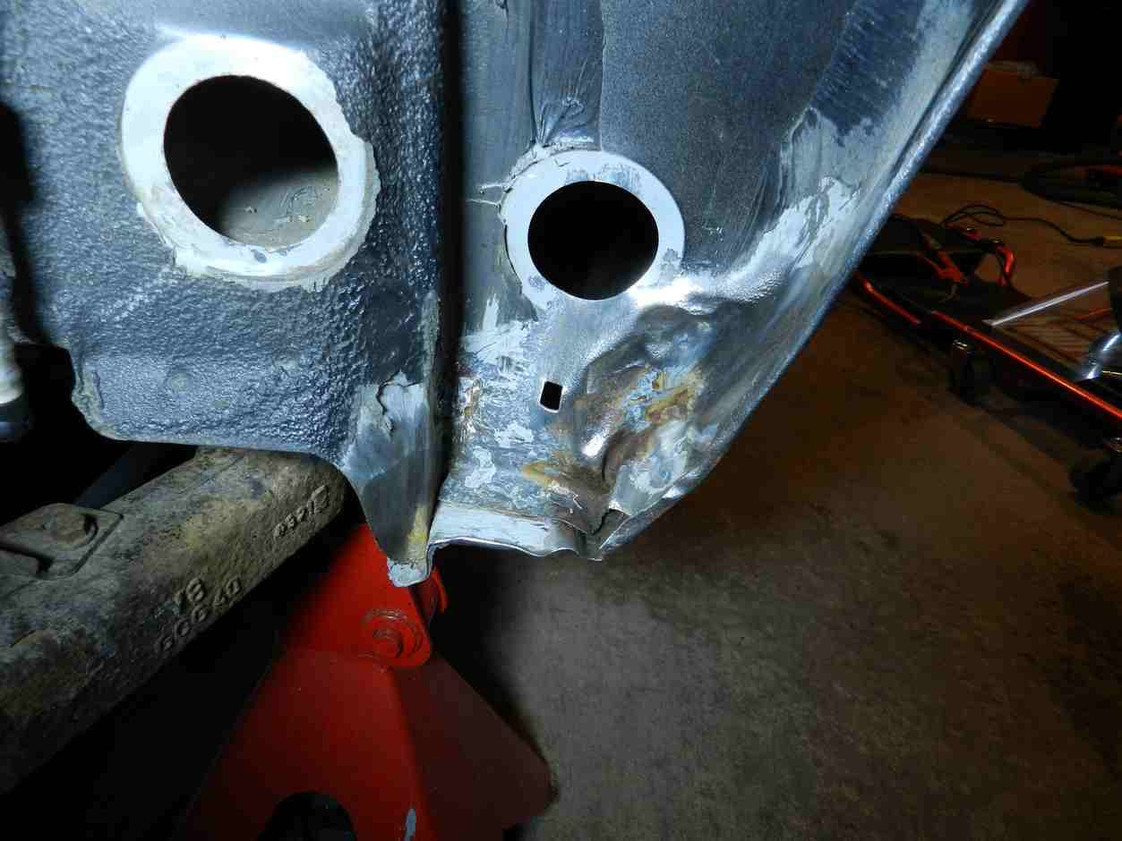

          More damage than I thought on the passenger rear rocker panel and I am not sure what to do. Rust didn't go thru so it is already good news.
          [img]5265[/img]
          [img]5267[/img]
          Dent is about 1 1/2" deep
          [img]5266[/img]
          Not sure if it could be pulled..... I'll start a thread in the body section for it.
          • #20
            Re: New to me R32
            Some por15 should treat that small patch of rust easily, and then you can paint of it. Rocker dents you have to pull with a stud gun thingy, Colin lent me one a while back and it fixed my rocker dent, was way worse than the one you have.

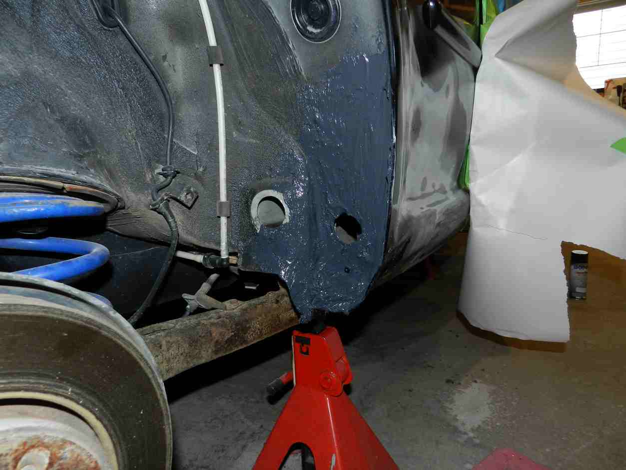

            • #21
              Re: New to me R32
              Thanks for the info Jerry. I thought rear rockers had more than 1 layer of steel and couldn't be pulled that way. I'll see Colin tomorrow to borrow his Uni-spotter.
              I used Por15 on our van and got some rust coming back after 5 years so I'll do different this time. Grinding/cleaning rust, rust converter, primer, brush-on seam sealant and 2 coat on undercoating. Just did it for the front fender, hopefully it should be good.

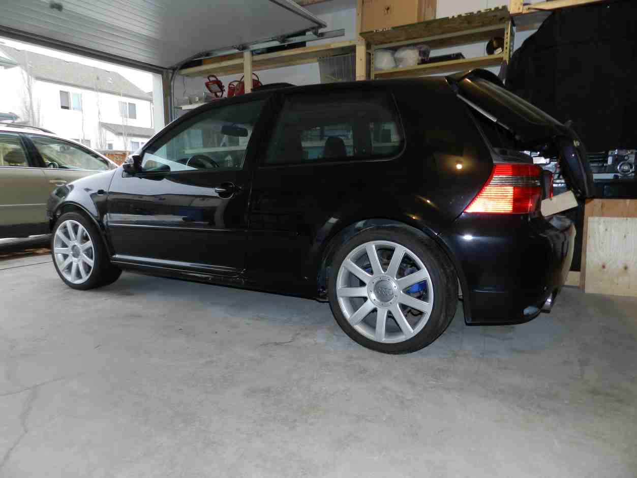

                  A little update on the R32.
                  Here are the TT rims
                  Rust and paint job is almost done for now, I need to finish the bottom where skirts are going but it will be later.
                  Sanding and polishing as well as wax done, what a job. Unfortunately, I wasn't able to put the car outside to get nice pics.

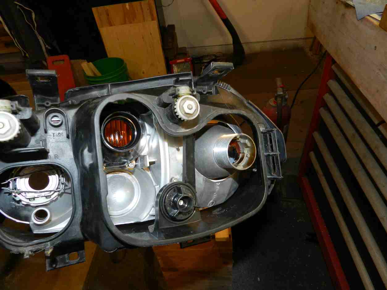

                  • #24
                    Re: New to me R32

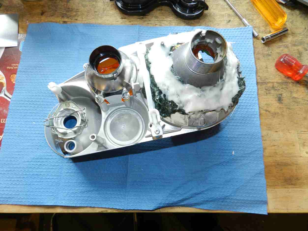

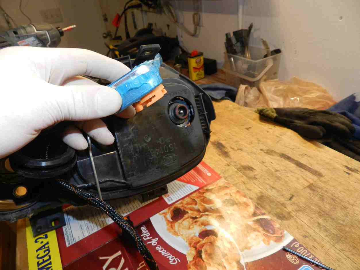

                    Some work on headlight too, it will be a little challenging as the projector is huge.

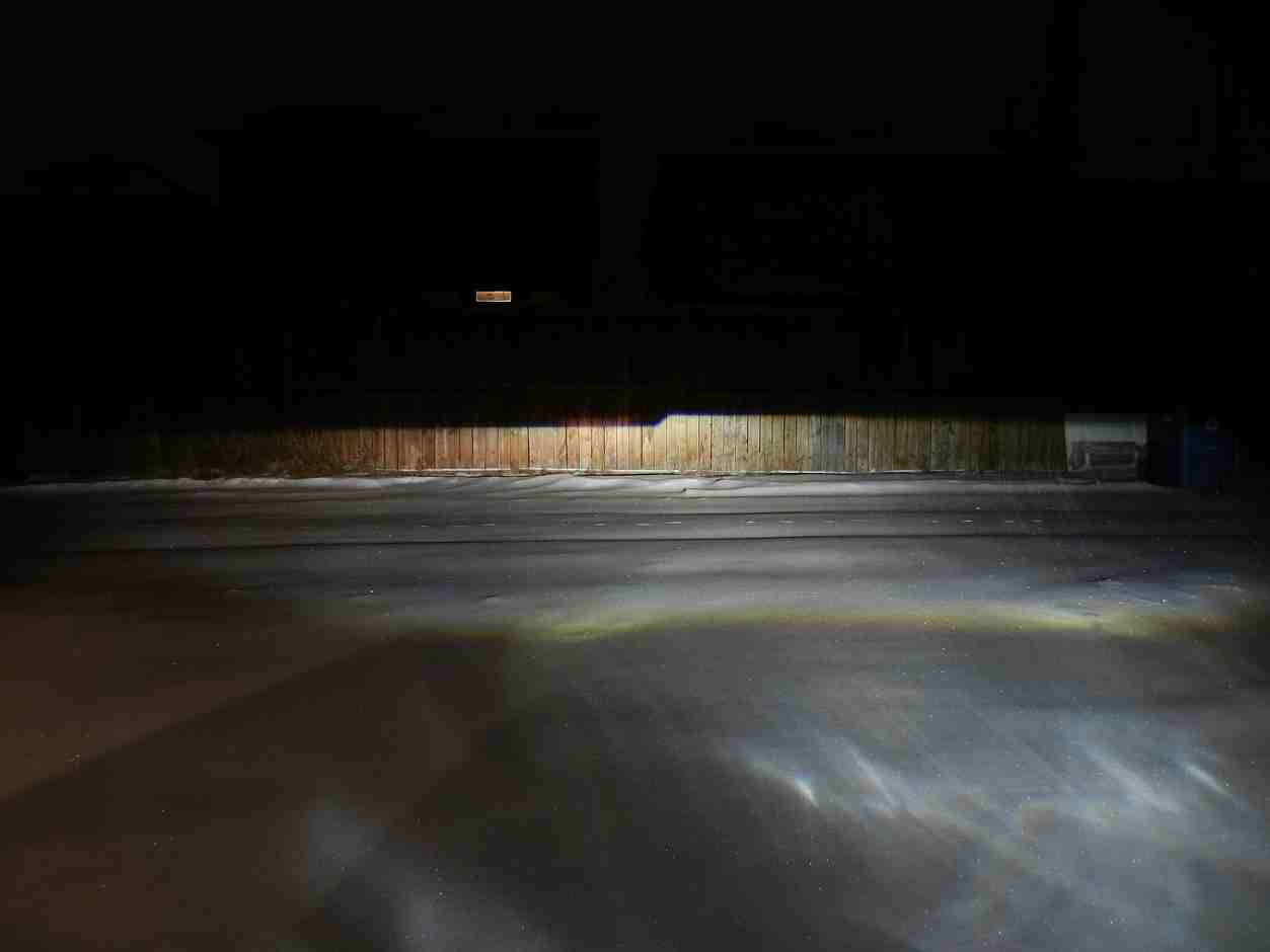

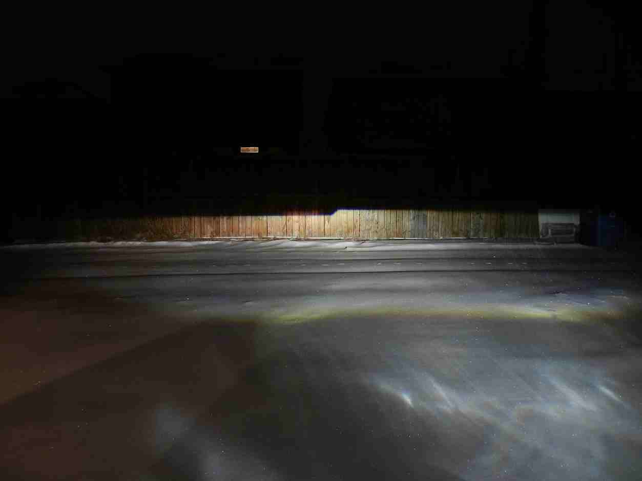

                    But the light output is quite nice

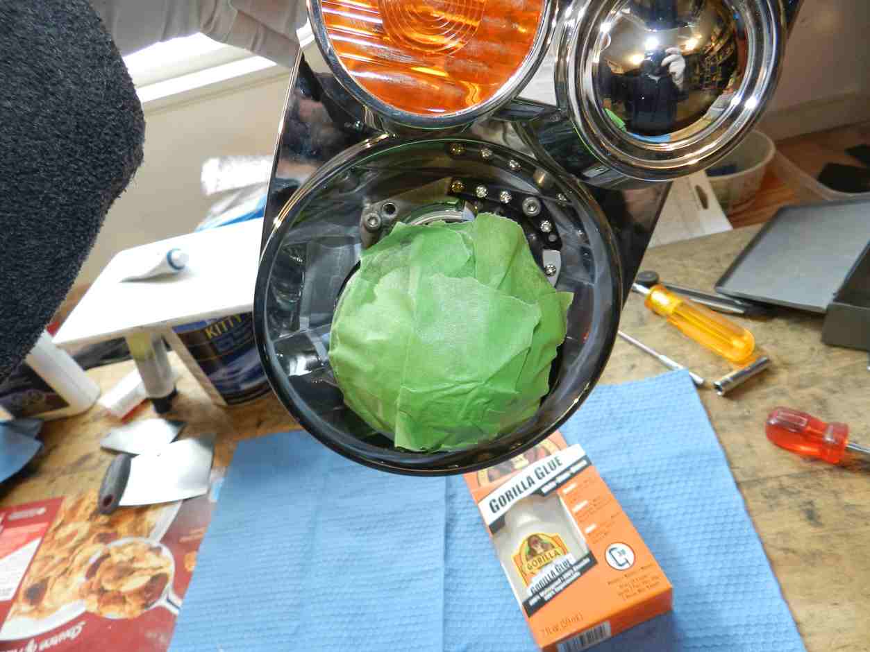

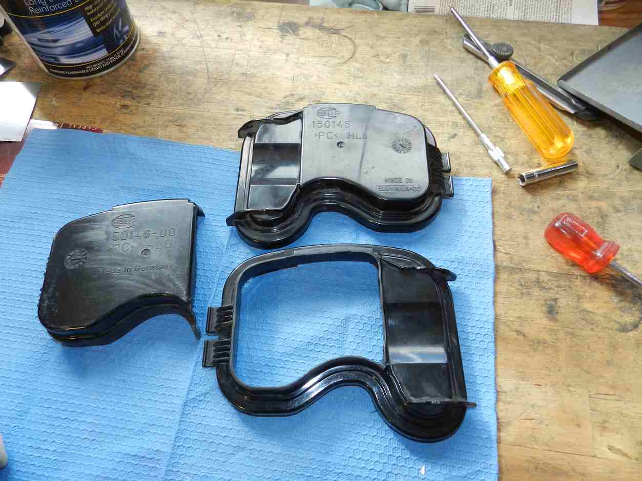

                    • #25
                      Re: New to me R32

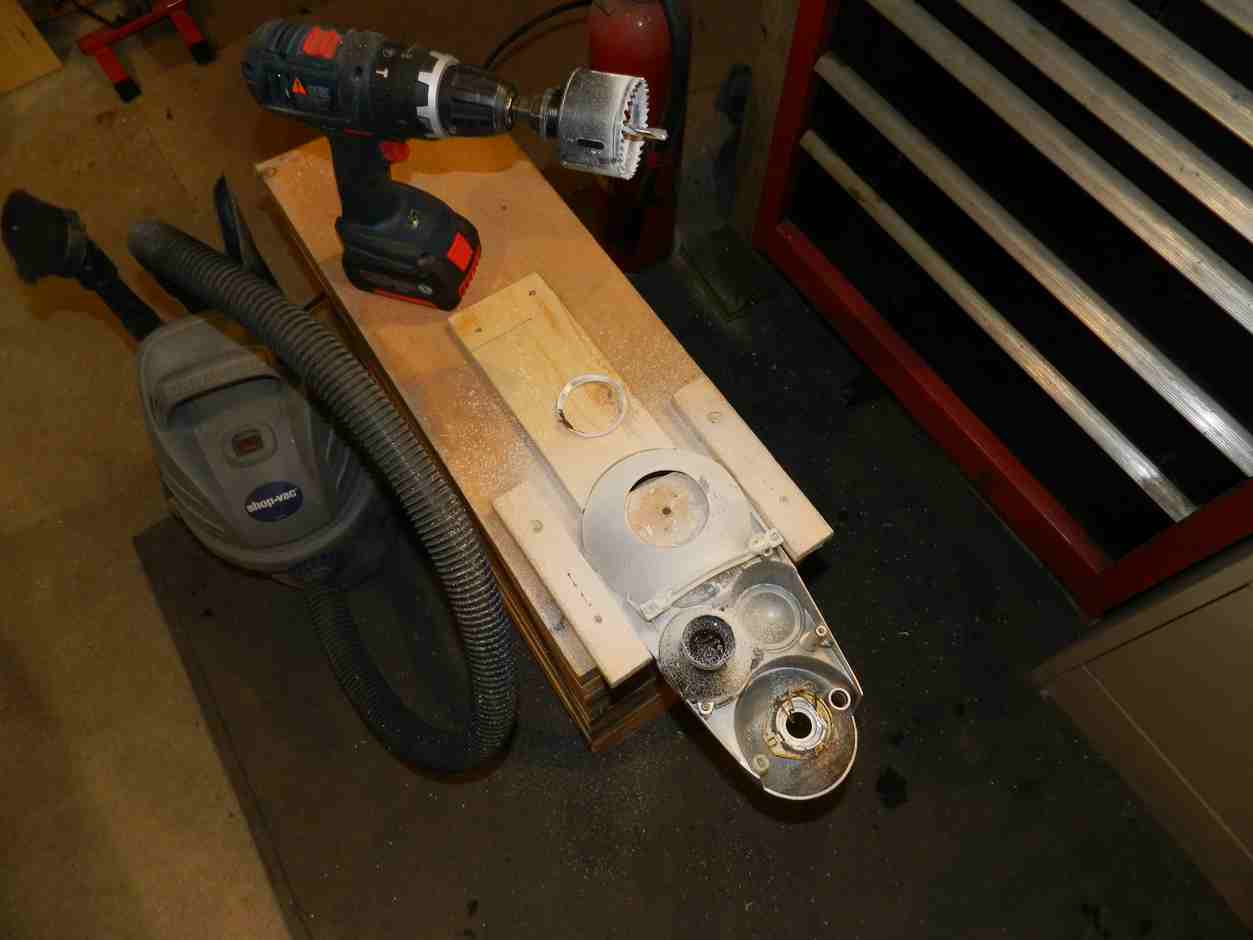

                      So, 4 screws 4mm diameter per projector should do it and even if I am going through the reflector, the projector seems to be heavy so I added fiberglass.

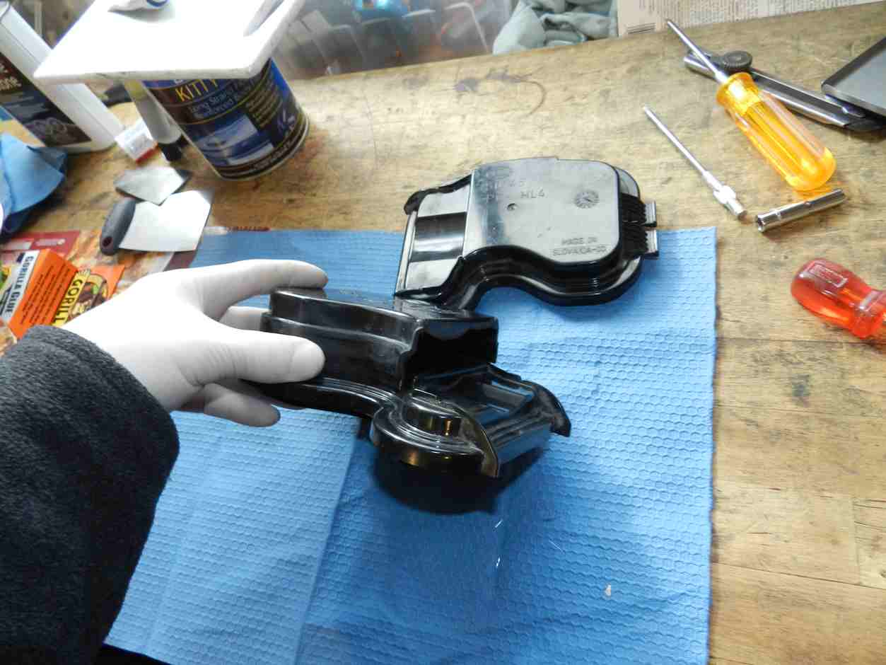

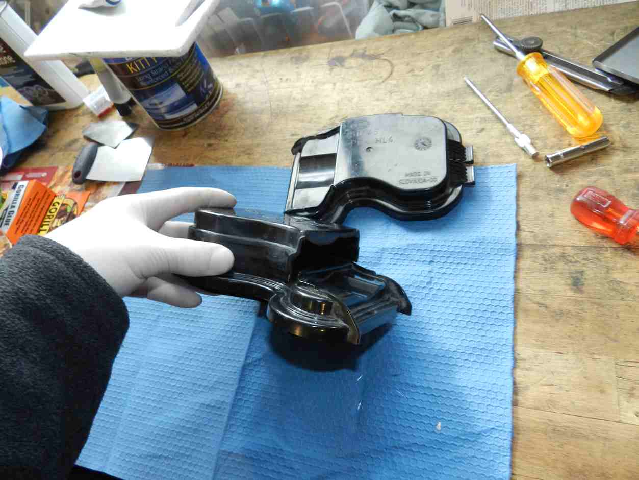

                      Of course, the bulb and ignitor need more room so I need about 1" more using a second part of back cover to make it
                      Working on 1 side for now as I need to make sure it will fit.

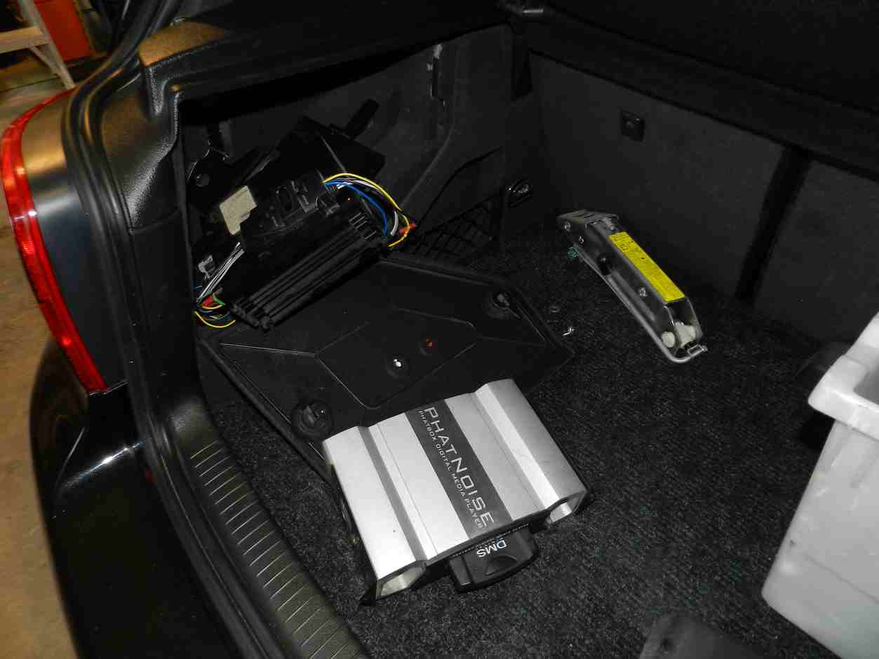

                        Thanks to Stefan, I got a Phatbox for the R32 but it might be challenging to make it fit in the trunk.
                        A lot of thing are in the way so I might take his advice and take the Phatbox apart.

                        Now if I could only find that CD cable in there....

                              Yeah I'd just completely remove the aluminum cover. It's grossly oversized. The black plastic front can be removed by prying on the lip on the bottom of the unit. 2 of the screws you need to get at are under it.
