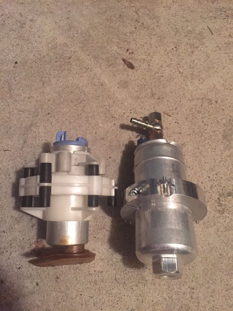

                  • Re: A Gambler’s Thread – e30mclow’s Replacement S4
                    Sooooooo apparently the wires on a Bosch 044 are reversed vs that of the OEM pump???
                    Found that out after inhaling gas for an hour last night. My head is banging today.
                    Anyway, it ain't running so I'll need to spend time at it tonight.
                    General photo comparative of OEM vs Bosch:
                        Got the wiring figured out, so she's now running.

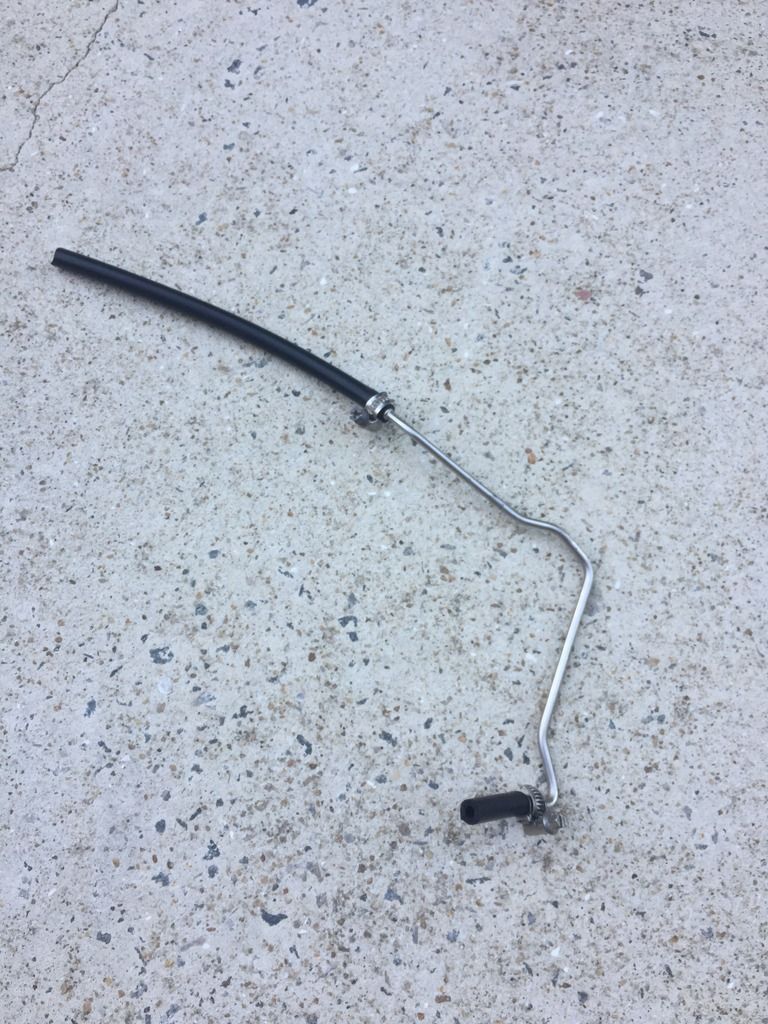

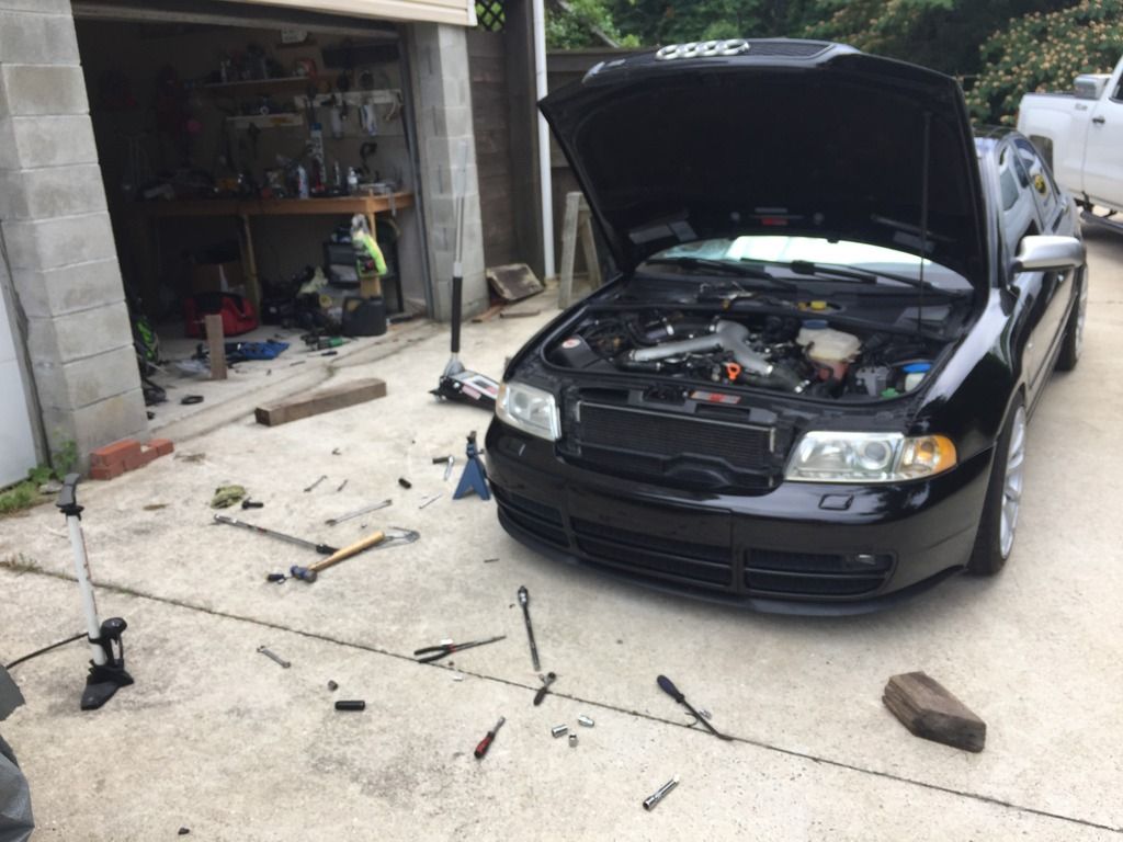

                            B5-ness occurring here in the last few days.
                            Evidently I have blown the new wastegate line going to the passenger side turbo.
                            Wouldn't you know it has blown down where the sun doesn't shine, meaning I need to remove:
                            - Front Sway Bar
                            - Pass. Engine Mount
                            - Pass. Engine Mount Bracket
                            - Pass. Inlet
                            then wriggle a replacement up in there somehow.
                            I'll firstly attempt to run a temporary line down there somehow and just abandon the one that is on it. That way I can absolutely confirm that this has been my issue, or if the engine needs to come out.

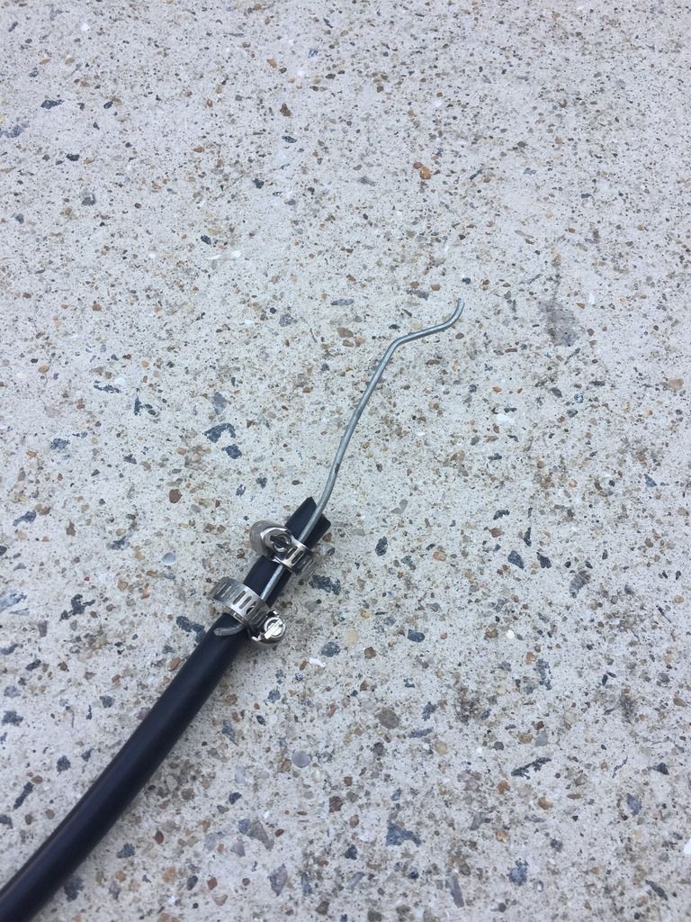

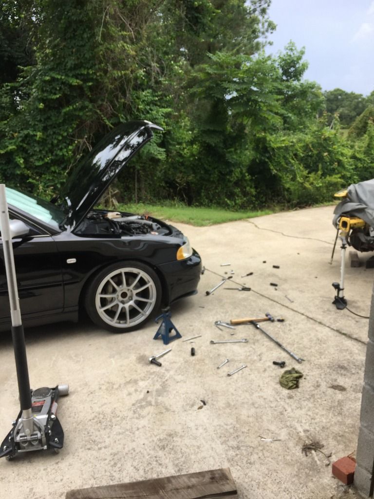

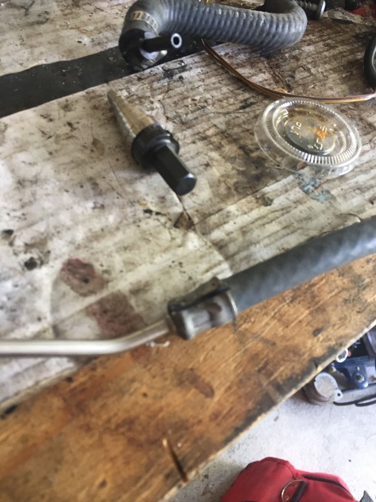

                              For future reference, this is what I did with the replacement line.
                              Firstly, stop going to the gym about 2 years before attempting this. You need pencil arms and the flexibility of a cheese string.
                              Arranged tools in order of requirement, in keeping with the scatter plot method.
                              Carefully cut the OEM crimps off without safety glasses and while wearing flip flops
                              Replaced both line with new silicone high pressure lines
                              Put a piece of steel wire on the end to help push the flaccid silicone hose up through the back of the block.
