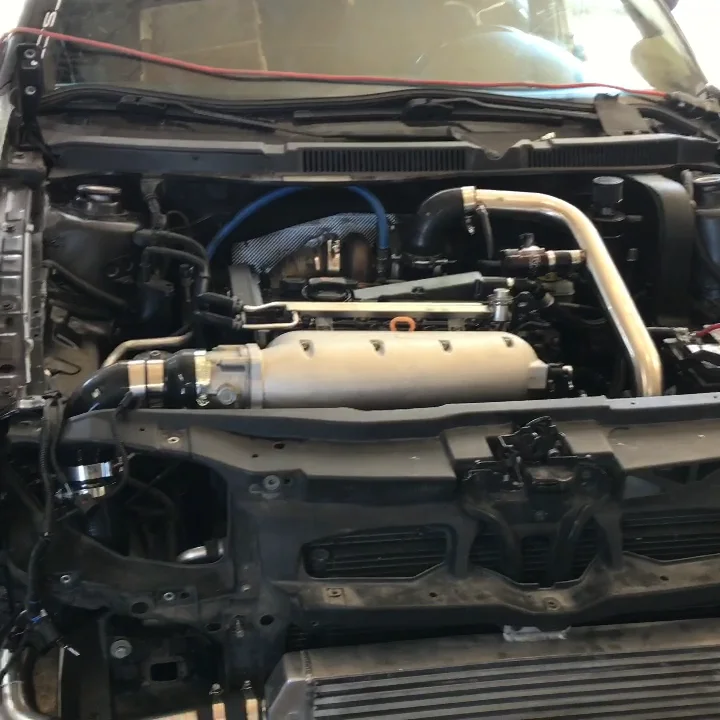

                      anyway threw the motor in... had to swap some sensors over as the clips on the s3 and gli were not the same... decided to go with a air to water intercooler to save my bumper this time and gain alittle bit of spool time... and some water methanol... the semi finished product...
                      and this is where we are now.. it's heading to get the downpipe and boost pipes fabricated this week... hope to be driving it next!!
                      .... ooo yea and some aggressive ass tires i need to try and fit .... lets see how this goes may have bitten off more than i can chew on this tire selection.
