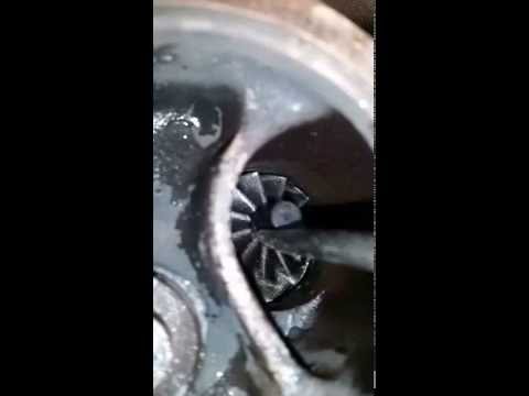

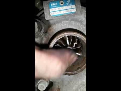

                    Drained the oil.. it looked like fancy black metallic paint. Neat, wonder what the hell caused all of this.
                    Tore more stuff off. Oh, by the way, every single intake pipe I took off was filled with oil... hmm..
                    I quickly found the problem when I took the pipe off the turbo inlet. Warning: Ko3 carnage ahead.
                    Took some videos to show the extent of the damage...
                    First, the intake side.
                    Notice how the nut thats supposed to hold on the front turbine was missing? And somehow, despite how aweful that was, of course the exhaust side managed to be in worse shape. Yep.
                    This could have been a factor to why the engine seized, but it also may have just been another casualty of neglect. I cant wait to tear apart the motor...
