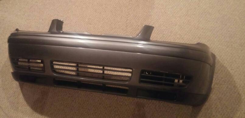

                      Got around to doing more work on the car last night. I've been pretty busy with school so haven't really had time. When ever i was under the car in summer there would always be a drip of oil between the transmission and engine so I replaced the rear main seal last night and also redid the gasket on the oil pan so hopefully it gets rid of that drip. Also got this 4motion lip from Colin at CAW. One of the tabs needs to be shaved down abit then it will fit perfectly!
