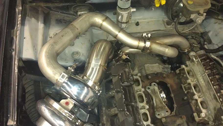

I cut out the secondary firewall and cut the battery tray back to the mount tabs for the steering rack. It gives us a solid 5" extra space in back of the motor. As well we cut and modified the passenger side frame rail to accommodate charge piping. The A/C is being retained, so a custom plate was made to utilize the old fittings, new lines will be run in Aeroquip.
