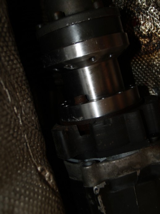

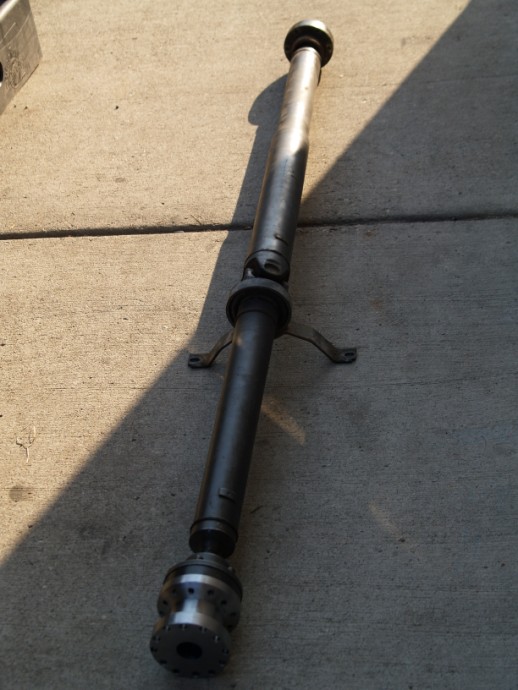

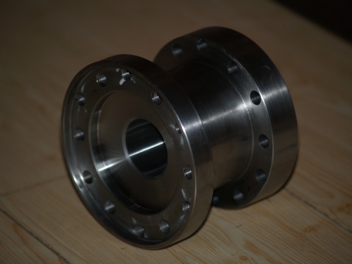

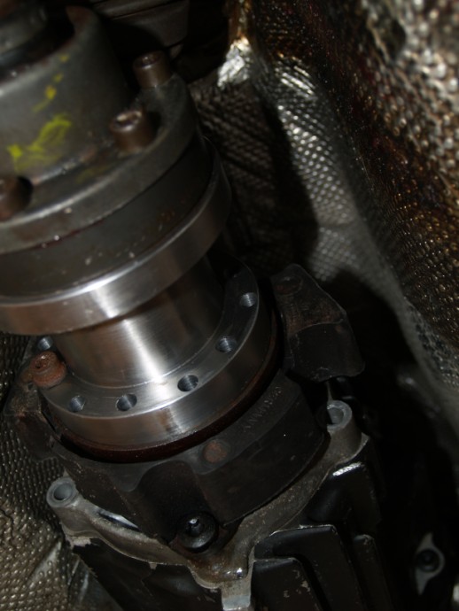

      Was out camping on the weekend so I got nothing done on the car, but today I picked up my new trans/propshaft adapter that I had my Dad's machine shop make. It is billet steel, drilled to accept 2 different CV's, all done on CAD and balanced. It fits perfectly and should prove to be a great option when doing a swap, as opposed to purchasing a new driveshaft.

        you should keep the CAD file and sell it yo
        • #64
          Re: 6 speed swap
          Hot damn that is pretty sweet, should work out nicely.
          • #65
            Re: 6 speed swap
            CAD file belongs to me, I am planning on getting them on the market if I can get keep manu costs low enough.

                The swap is finished, I still need to re-code th cluster and get final tune flashed. Car is running like crap, so I have to spend sometime and get it sorted.
                edit: Car is running an S4 A box, bosch MAF code, I have a Hitachi. Unplugged the MAF and no more major issues. I think that when I get the new code flashed in I should be OK
