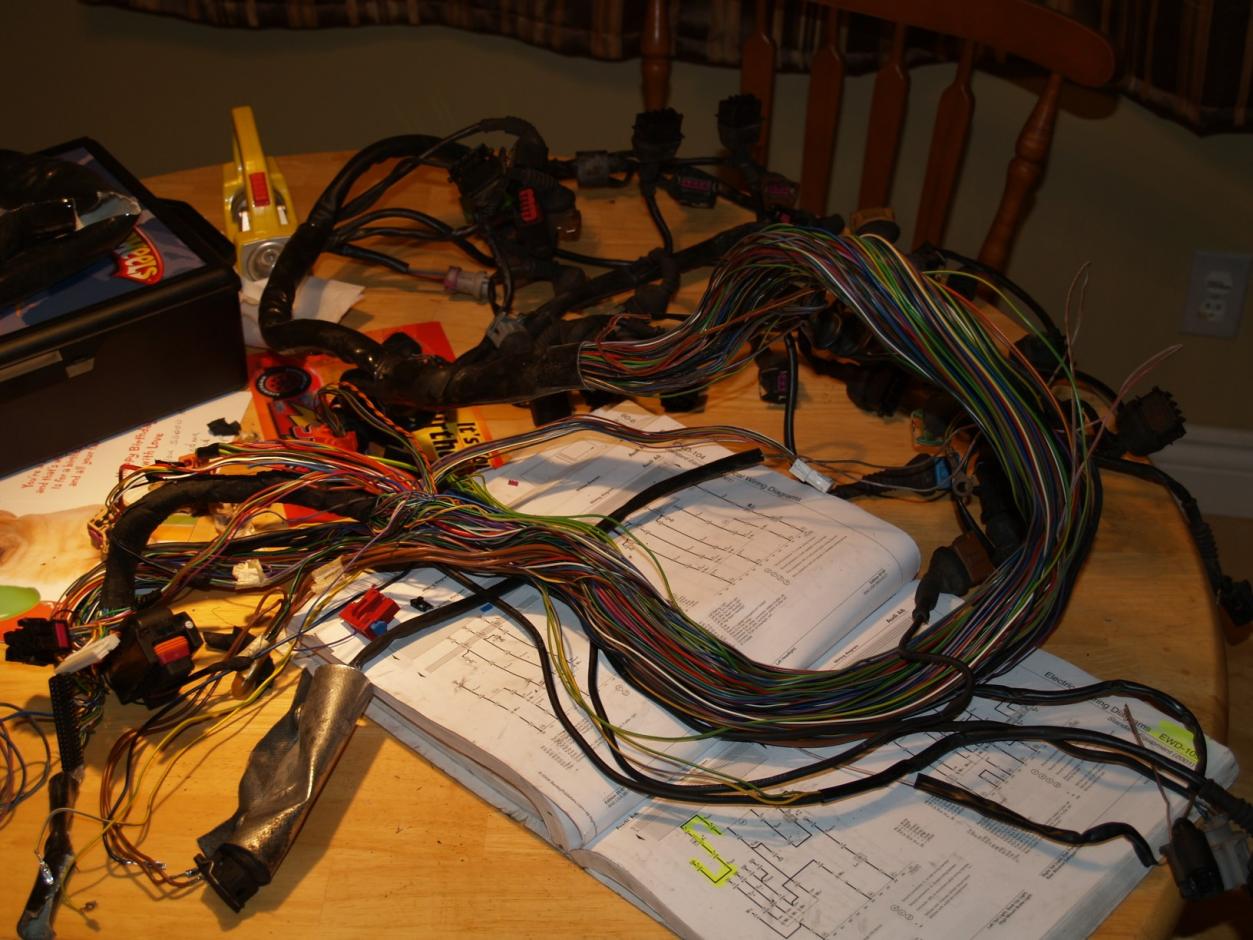

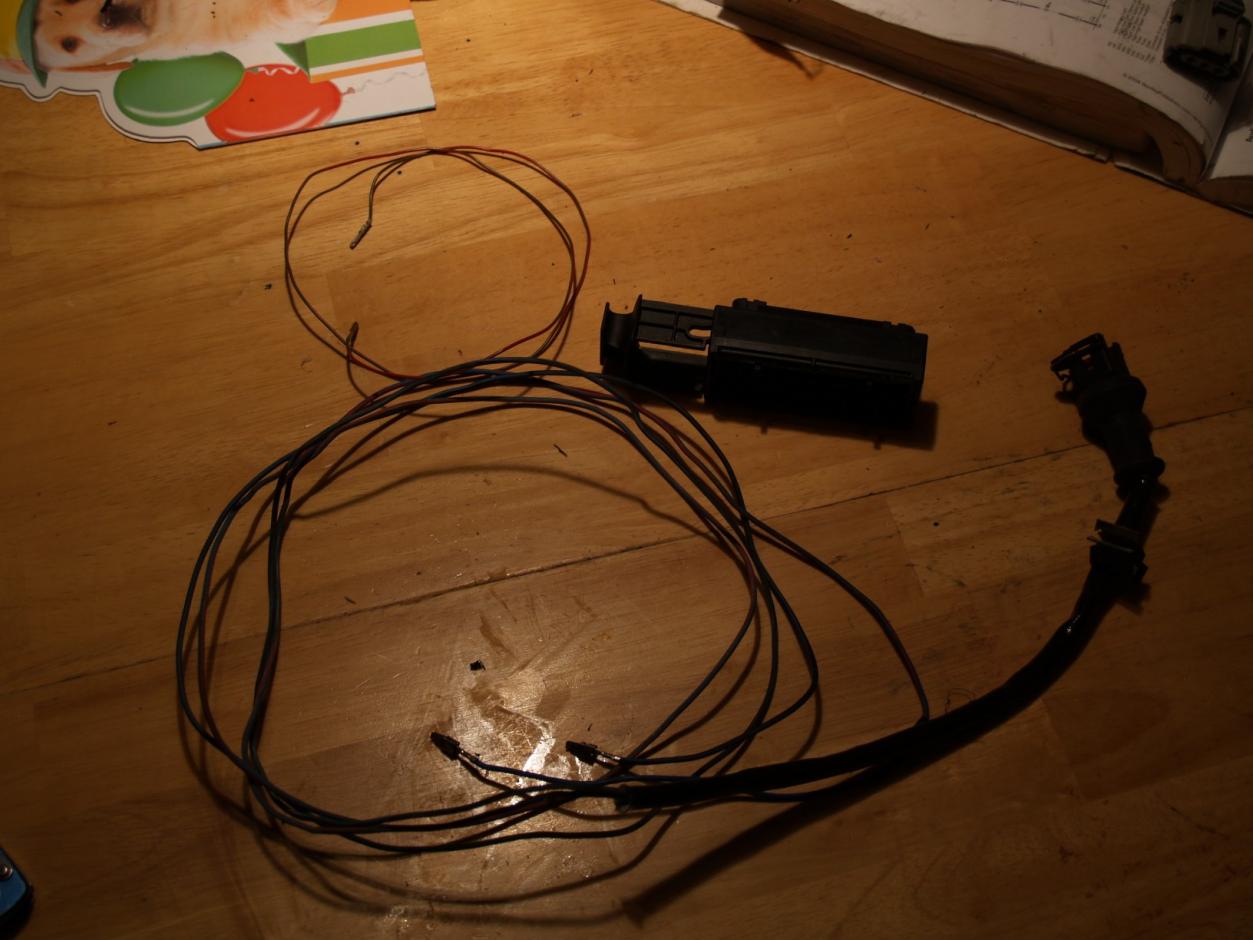

          I got up early this morning and sarted wiring. First off cut open my OEM 6 speed harness. I am not using the harness as is because it is from a 2k S4 with Bosch MAF and it has some points that look brittle. From the harness I located the reverse light switch and pulled the entire wiring assy out of the harness, removing it from its brown and red conectors back at the firewall. Next up was to open up the ECU harness and pull the wire for the clutch vent switch, I followed it back to its connection point at the white firewall connector and removed it. These 2 sets of wires will just pop into my existing TIP harness. I also pulled all the wires from the larger of the 2 ECU clips, this is due to a slight difference between the A box connection and the T box connection. I am only swappng ECU's because I am selling the T box with GIAC programming to recoup some costs.
