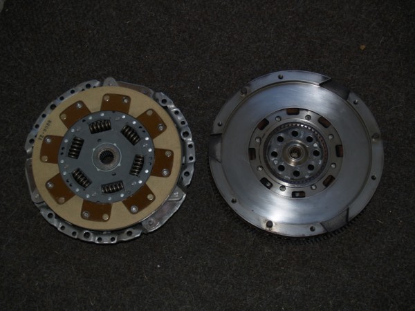

          Not to be outdone by Graeme, here are soime pics of my new clutch and flywheel, I resurfaced the flywheel myself, actually worked out pretty well

            Re: 6 speed swap
            Yourself??? Or did you have that shop do it?

              Re: 6 speed swap
              Myself, there were no groves. so I used some cutting oil and emery cloth, put a straight edge across it and double checked for gapping.
