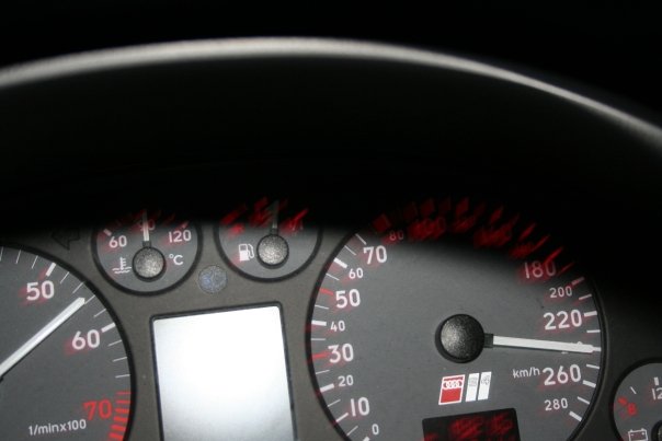

    just an FYI to how fast we can roll with lots more legs i've seen a k04'd s4 doing 188 MPH and the speedo was wayyyy low.. i beleive 188 or 190 is max with gearing and engine.. jordan or kyle may know different tho

    The stock ratio of 6th gear is the limiting factor here. There is plenty of power to push all the way to 7000 rpms, but you max out the tranny at 309 kph. There is talk of swapping in a 6th gear from the euro TDi tranny with a lower ratio (0.60 as opposed to the stock 0.68 IIRC) to raise fuel economy, and subsequently, possible top speed. That would put 6th gear at 350 kph at 7000 rpm
